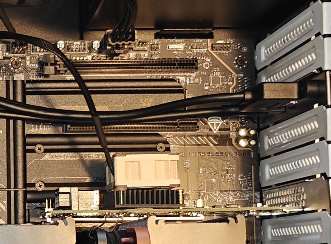

Do you have a fan on your current card? I bought a small Noctua 40mm that fit almost perfectly on the heatsink of my LSI 9300-8i.
If your storage array is made up of HDDs, maybe a SAS expander is potentially cheaper than another HBA card. I do believe the 9300-16i is using two SAS3008 controllers, and requires extra power via a 6-pin connecter from the PSU.
Yes I put a small noctua fan on there too. That caused the card to take up two slots though which is mildly annoying.
I ordered another 8i as I became convinced that the 16i had two controller chips and eight drives isn’t a terrible limit at the end of the day.
How did you fit your fan btw? Mine was via zip ties…
I used a couple screws that fit in the fins of the heatsink.
