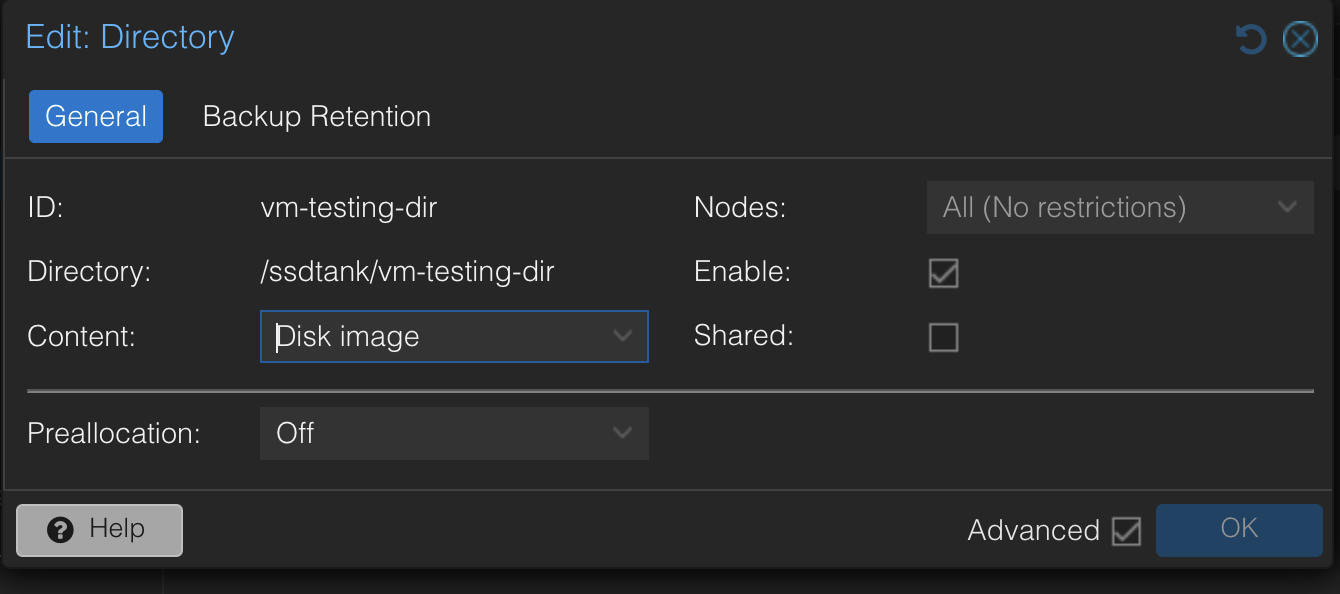

Directory Storage
(if there’s a better name for this, I’m all ears. The Proxmox manual just refers to it as a “storage”)

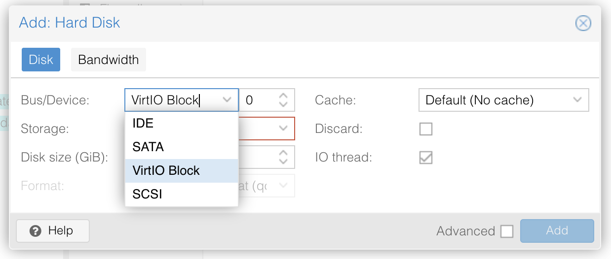

That does look correct. The performance advantage of raw vs zvol applies on both Linux and FreeBSD, but I don’t use virtio-scsi, I just use virtio. That might be the difference.
Hmm, I don’t see just “virtio” as an option in the web UI
I’ll play around with the different options and see if one of them offers better performance.
you need to choose “virtio block” as bus/device type when adding a new harddisk.
Where in the config file might it say “virtio”? Would you be able to post an example config file? That would be very helpful. I’m having a hard time finding info on QEMU storage drivers.

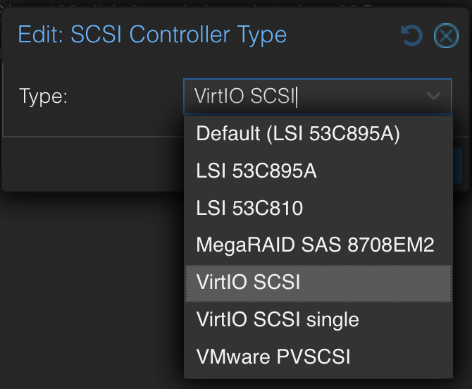

Whew, okay I did some more digging at here’s what I found.
virtio-scsi vs virtio-blk
In Proxmox, the default SCSI controller in the UI is “VirtIO SCSI (Single)” which translates to a KVM argument of -device virtio-scsi-pci,.... Though it is not in the UI as an option, another controller is available. If you create a VM, but don’t start it, then edit /etc/pve/qemu-server/ID.conf you can change the value of scsihw to virtio-blk. Once the VM is started, the KVM argument will be -device virtio-blk-pci,....
There’s not much info online about the difference between these 2 types of devices except for this QEMU article so I decided to add that as a testing dimension.
