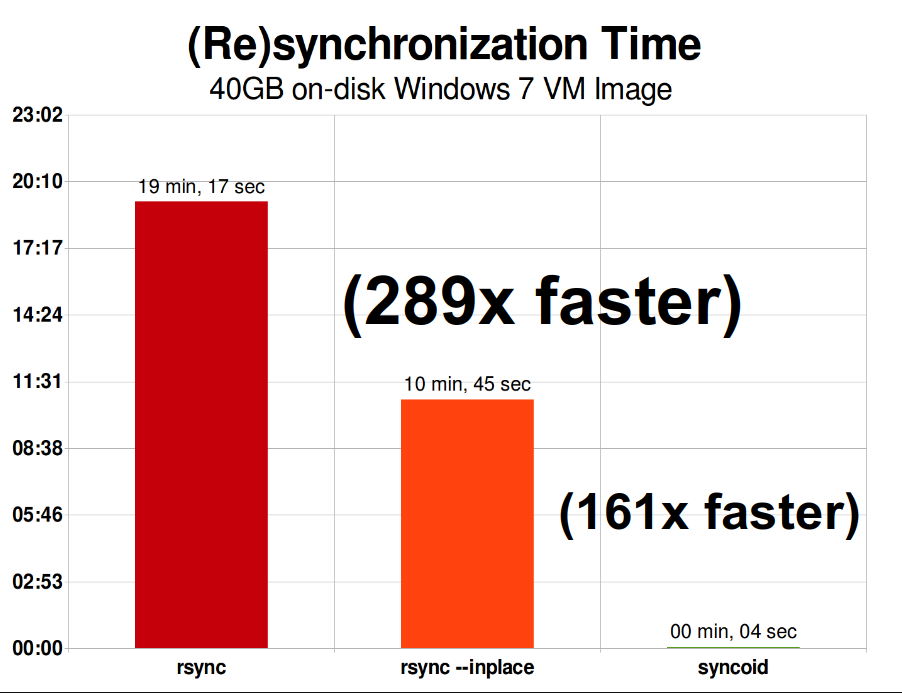

But what about the vm/container disks? They are files on a dataset, not VDEVs but small changes, like log entries would trigger a full re-transfer with rsync. Is there a better option for this? I could split the backup solution between the two different data types.
Thanks in advance.
Not if you use the --inplace argument. You’ll still have to read in the entire file on both sides locally, but you’ll only transfer and write the delta. For an example of the difference that makes, see the replication section of the ZFS 101 piece I wrote during my stint at Ars Technica:
Thank You for the enlightenment! I will incorporate this.
