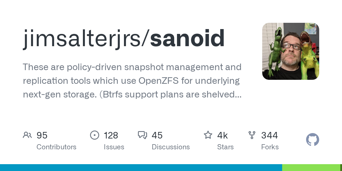

The more I thought about this, the more I thought it deserved some quick tooling in the Sanoid project itself. You can find a fledgling version of the new tool findbay in MASTER of the project’s Github, from which it should make its way out to distros after our next release:
I’m still working on the tool, but for the moment, you can pass it any string sufficient to uniquely identify a drive–for example, the last 4 of the WWN, or whatever else you can see in the output of zpool status–and it will return a raw devicename.
