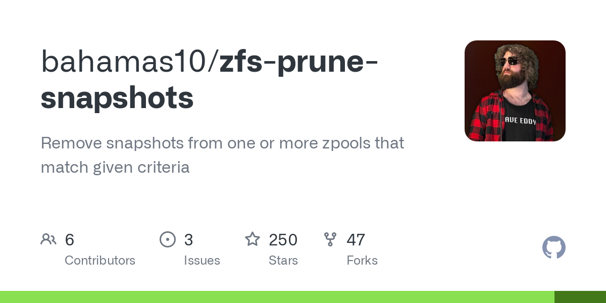

Im a bit late to this party, but I would like to link to a script I use for removing old zfs snapshots. It is pretty simple to setup in a crontab.
