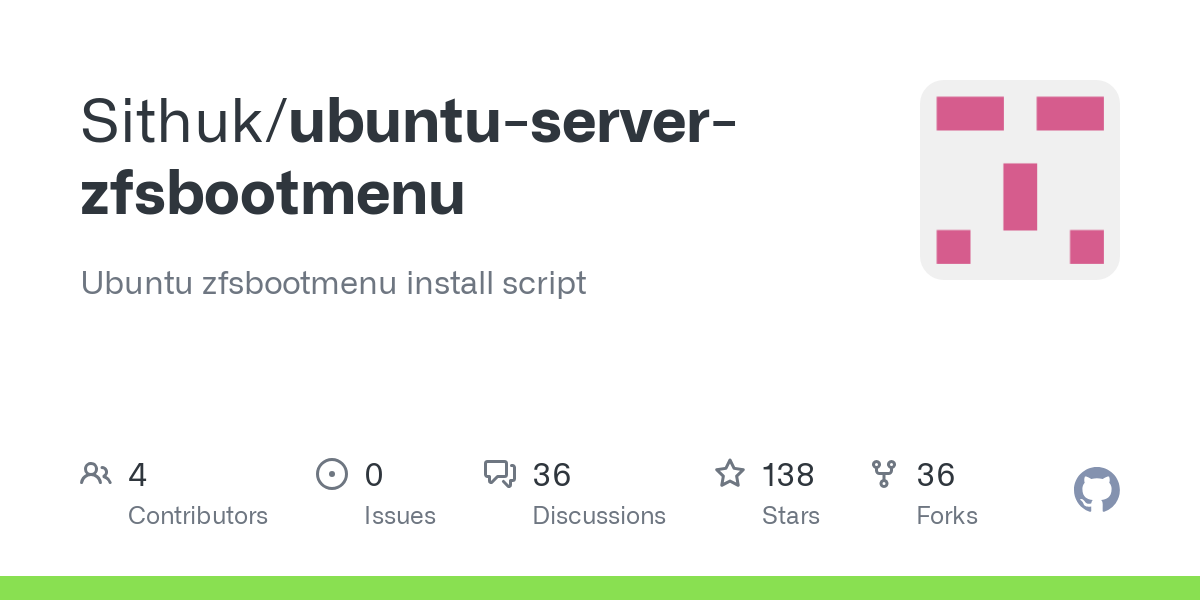

I’ve pulled together an installation script for ubuntu zfs on root at the link below. It uses rEFInd + zfsbootmenu and has options for desktop environments. It might be useful if you are finding the default installer options limited.
