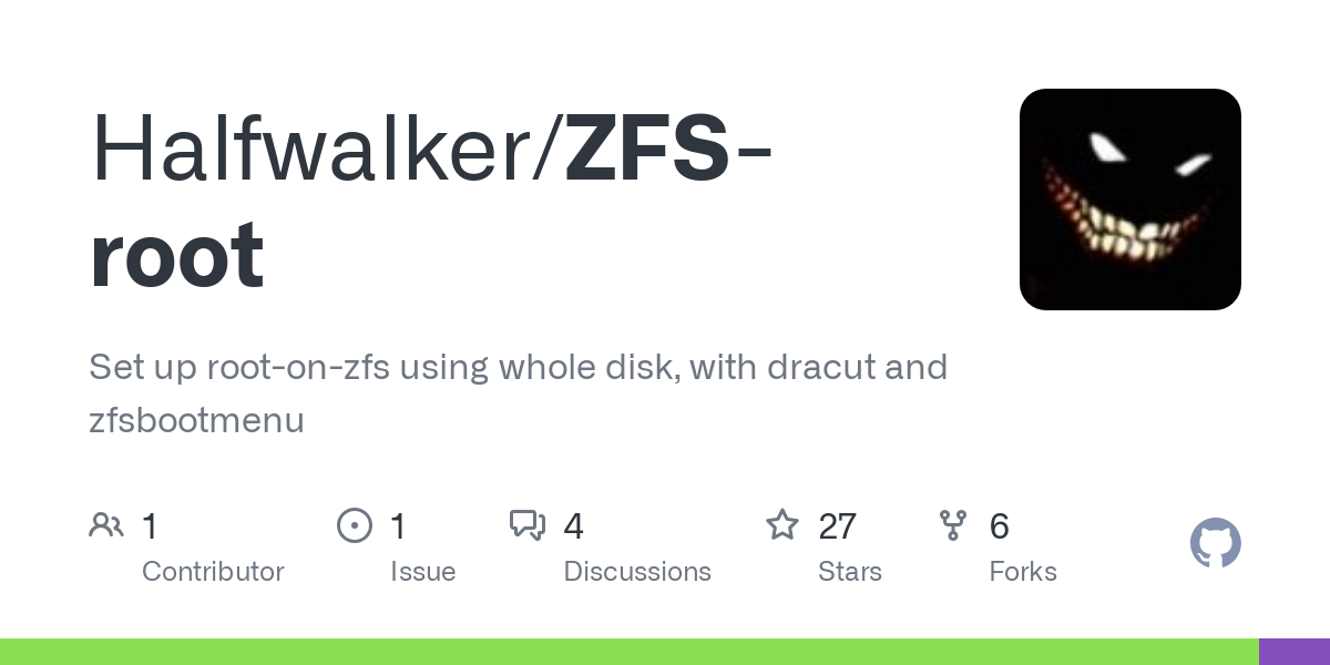

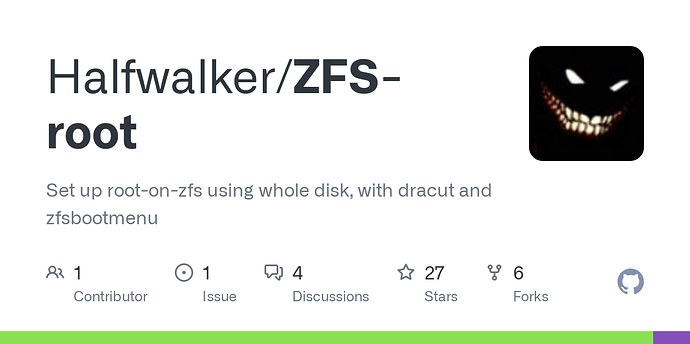

I have a fairly opinionated script to build a root-on-zfs system based on Ubuntu, rEFInd, zfsbootmenu, Dracut. I use it extensively for all my own systems, of various flavors … laptop, workstation, general server, media box etc.
It’s easy to test, works fine under virtualbox. Also has a packer setup so you can build a qcow2 image that can be booted under many different virtualization platforms for messing around with.
I have the process for integrating UEFI SecureBoot working now, by signing both the rEFInd binary and the zfsbootmenu unified kernel/initramfs. Just needs to be made a bit more robust and I’ll push the commits in a week or so (if that’s of any interest).
