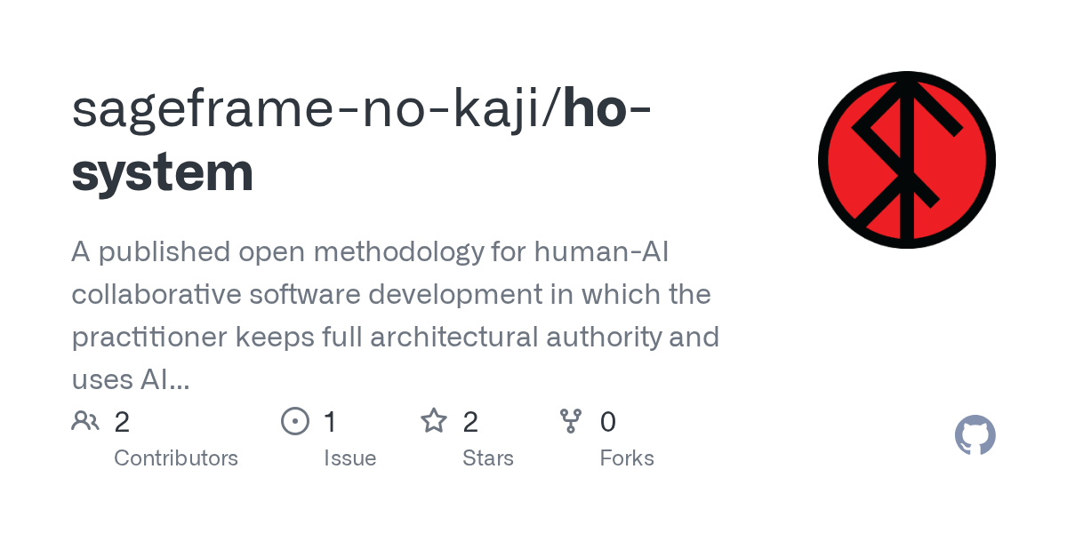

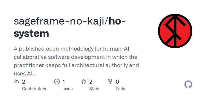

Coded entirely by humans, or in part by Claude or some other LLM?
(That’s not an accusation, but it is a question.)
Edit: answered my own question. For those who do not wish to partake of AI-built code, this may not be the project for you.
No accusation received!
Yes, I do use coding agents to write the code. Thanks for linking the Ho System—that’s mine too, and it’s how I organize the work. I make the design decisions, then work through implementation, review, and testing in small steps. I’ve published the build record palana/ho-process at main · sageframe-no-kaji/palana · GitHub , including the problems we’ve found and the fixes. Happy to answer questions about any of it. The software is working for me and I’m here to share and invite scrutiny.
