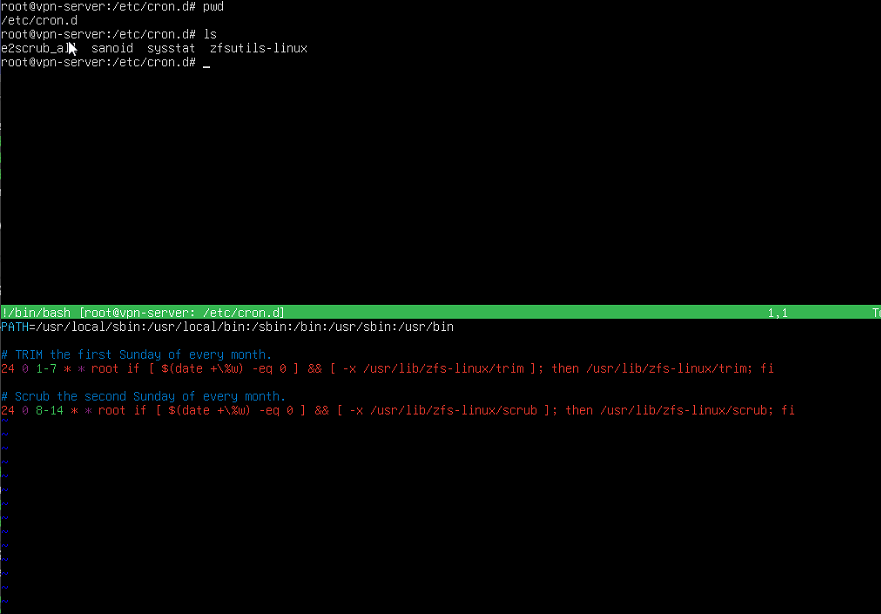

Not sure that Ubuntu does automatic scrubs, unless you set a cron job?
Good idea :slight_smile:
I believe that the cron job is all setup for you, I found this file under /etc/cron.d/zfs-utils-linux.
