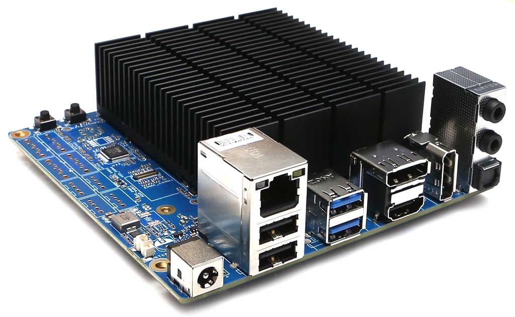

Honestly, though, a separate always-on device might really be a better idea. It can be very small and very low-power; have a look at the $139 Odroid H4+. You get a quad-core Alder Lake x86 CPU, 4 proper SATA ports, and extremely low power draw (they recommend a 60W power supply, or 133W if you’re using full-size 3.5" drives. CPU is TDP 12W, and the entire system should idle at 5W or less, depending mostly on how many drives you stuff in).
Note that the $139 I mentioned gets you the processor, board, and heatsink. You’ll need to add RAM, whatever drives you want, and a PSU and case. If you want to go with a pair of 2.5" drives, Odroid’s Gamecube-style case would work well: https://www.hardkernel.com/shop/h4-cube-case/
Their 60W power supply, with a UK plug (I think that’s where you said this would be going?) is $10: https://www.hardkernel.com/shop/15v-4a-power-supply-uk-plug/ The 130W one is $25, but I’m not sure if they’re currently offering it with UK plugs.
If you’re just doing a pair of 2.5" SSDs, though, I think you’d be perfectly fine with the 60W supply.
