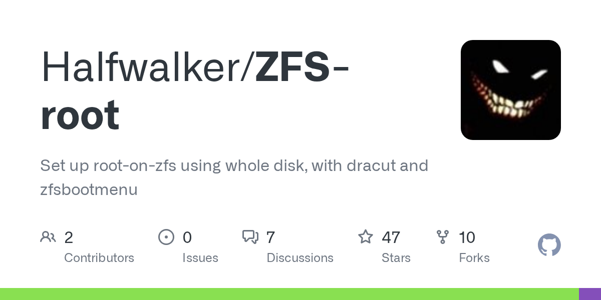

I have a (opinionated) method of installing Ubuntu as root-on zfs
For a basic system there are 2 partitions, the UEFI/BOOT one and a ZFS one. You can have multiple root datasets and select which you want at boot time via zbm. Can boot from mirror/raidz multiple disks too, using mdadm to keep the UEFI/BOOT partitions in sync.
No grub (uses rEFInd instead), no separate bpool special snowflake. You don’t HAVE to use rEFInd, can just boot directly into zbm if you want (though I don’t have that as an option, it should be pretty easy to do).
This is the method I’ve used for pretty much all my systems, laptop, encrypted laptop, workstation, media server etc.
It’s easy enough to test in Virtualbox or whatever, and there’s a packer setup for creating a .qcow2 image too if you want.
