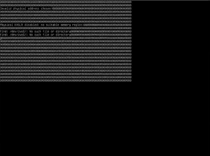

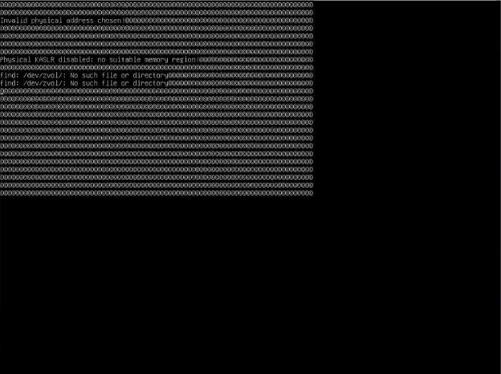

I am installing Ubuntu ZFS on Root in a Hyper V VM (I don’t have a choice regarding the host OS) and I am receiving a “Invalid physical address chosen! Physical KASLR disabled: no suitable memory region!” error.
I can’t seem to find any current documentation on this at all and I am wondering if it a specific ZFS Boot Menu/Debootstrap install quirk as using the standard ubuntu installer on EXT4 works fine.

I have tried this with the ubuntu server installer and have the same issue, it’s leading me to think that there must be some kind of issue between ZBM and hyper V which is really weird.
