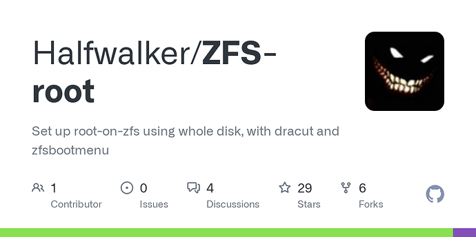

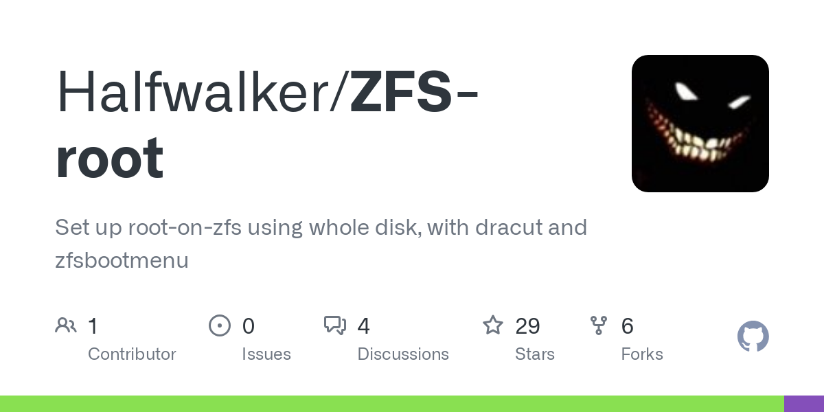

Toot my own horn here a bit … Everything at home and a fair amount at work is root-on-zfs, based on my setup script
My laptops are all done this way with zfs native encryption. Servers at home no encryption (yet).
Have a look. It’s an opinionated setup, but the choices make sense I think.
It’s Ubuntu-based, but should be pretty easy to handle PopOS as well. Change the repo definitions, and maybe a few package choices.

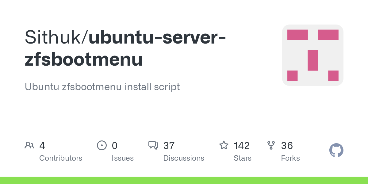

You mentioned you unsuccessfully tried to install zfsbootmenu on ubuntu 24.04 but couldn’t get it to boot. You could try the following install script for zfsbootmenu on ubuntu 24.04 and see if that works.
